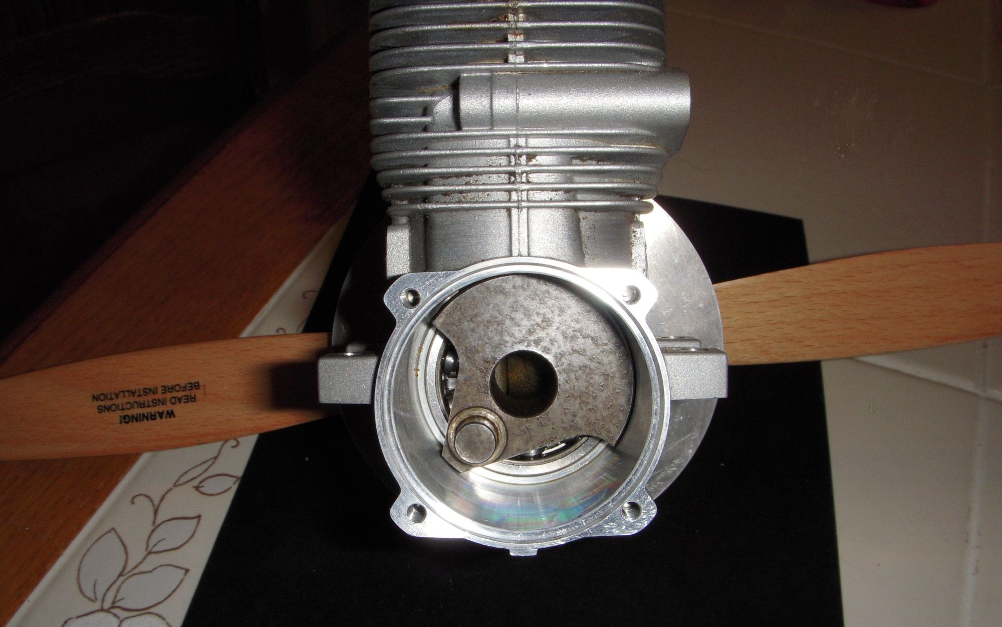

Once the bearing is out, the engine is still really hot.. Carefully wipe out the castor build up where the bearing was, then take the front bearing attached to the crankshaft in the freezer and push it into place.. It goes in really easy, then immediately shove the rear bearing in place from the back...
