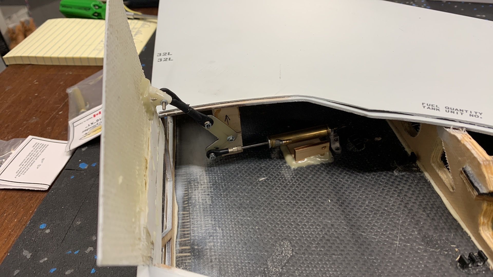

New MAP Cylinder installed with new linkage setup on the wing inner door. Measurements are given in the video. This was the most time consuming thing to complete on the wing. Skymaster lock nuts installed on the cylinder so when closing the air cylinder isn't trying to over pull itself and close the door further than designed.
