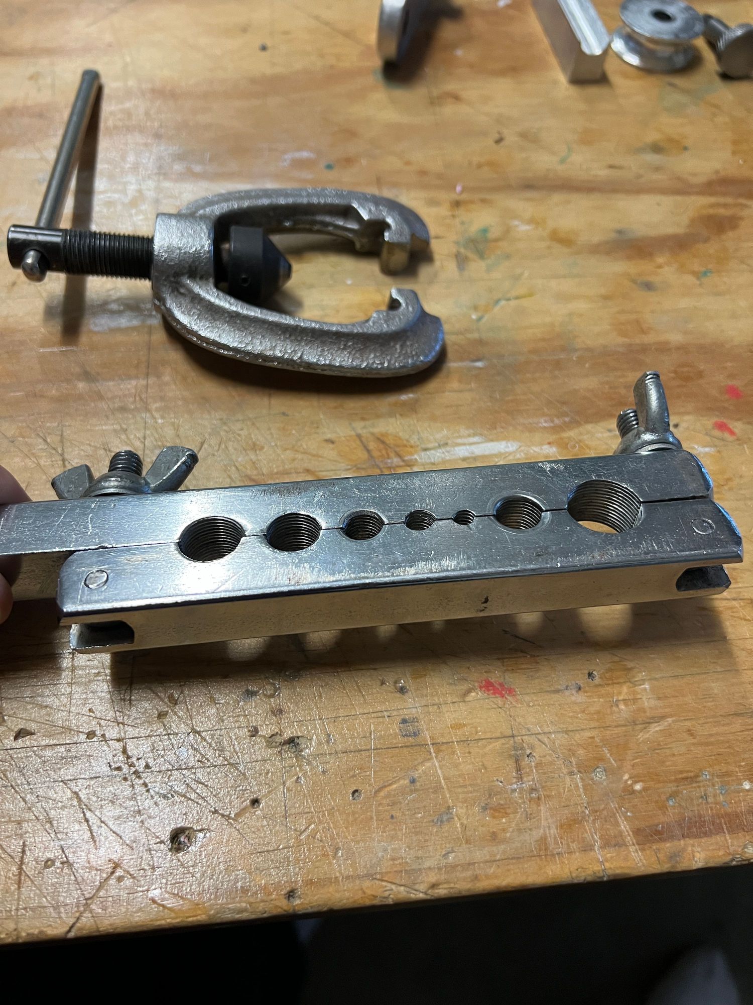

. . . .by flipping the clamp over and using this non-beveled side tapping the flange perfectly flat. It is at this point I fill with cerro, place the flange into the jig stop and make the bend.
