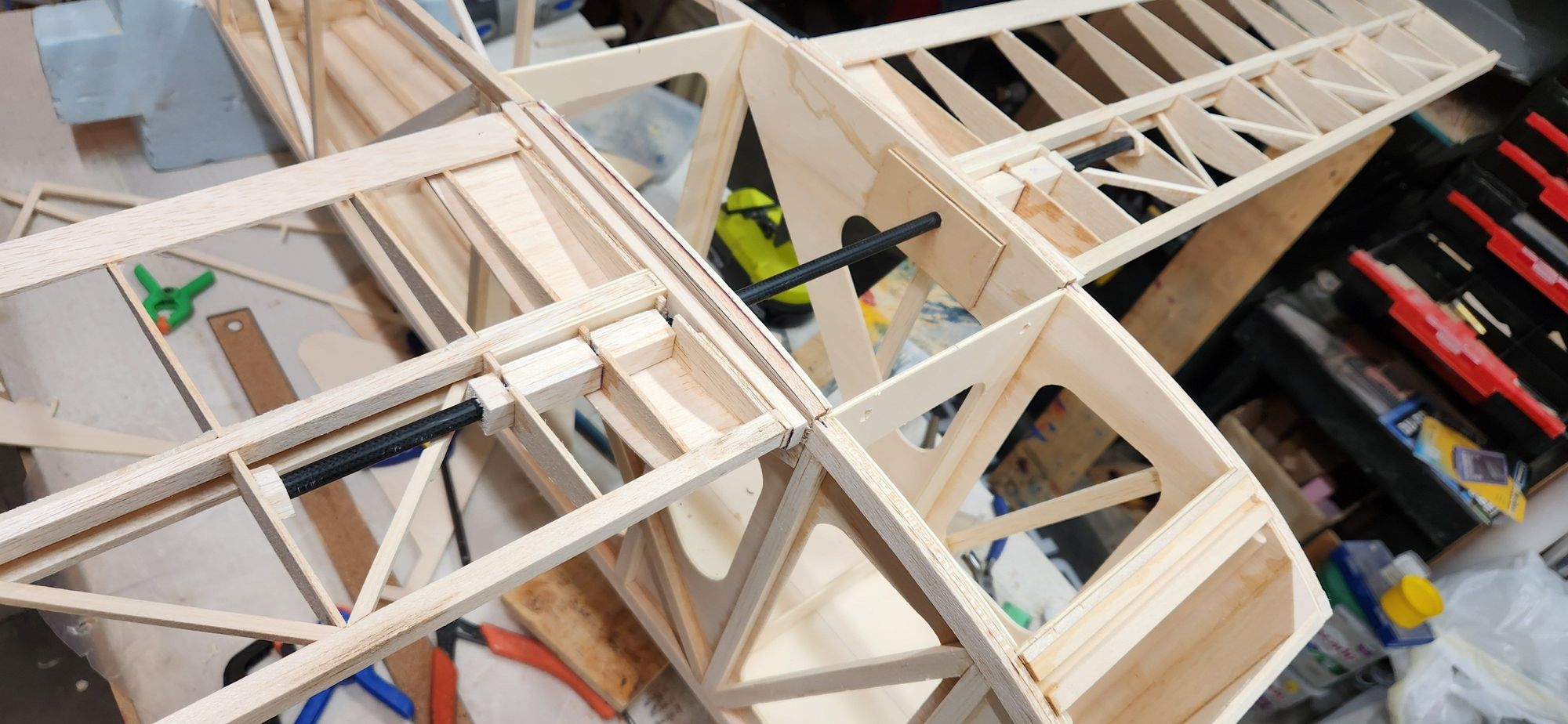

bryanmiick November 11, 2024
I cut the ribs and installed carbon tube from leftover Sig Cub pushrod while angle and dihedral were held in position by spar and leading and trailing edges. I then built boxes between the ribs to hold the tube in place. then I filled in the wing saddle on the fuselage with the plywood that was removed and some 1/4" balsa and reinforced it with 1/8 aircraft ply where the tube comes thru. this holds the sweep and dihedral in place.
