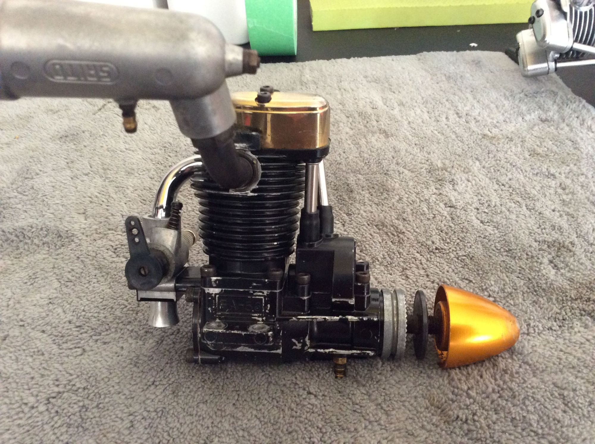

1200SportsterRider May 17, 2025
Typical 50 and 56 LS needle setting, about 1/16th" below throttle arm face. 1/8 turn rich from lean hesitation is about perfect.
